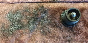

Drain the gear oil and look for sparkles in the oil ??? If there is some Its a strip down But you get to know the bike

Do NOT just jump in and start pulling everything apart
Eliminate the possibilities before settling on dismantling
If the oil has no sparkles it may just be very thin / wrong grade etc etc

Picture attached. No large pieces just a bit of sparkly sludge. ??
