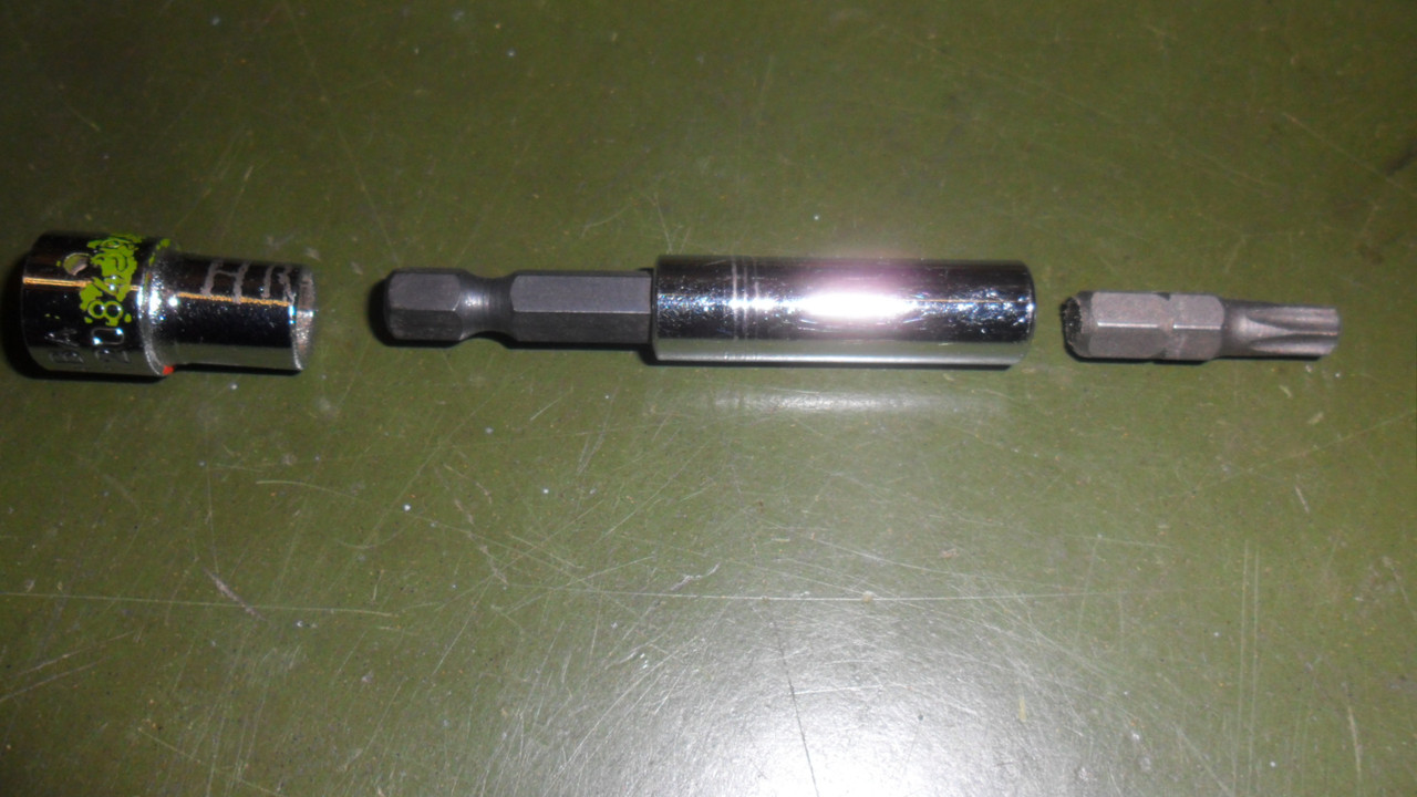

Tools Needed
PH2 screwdriver.
PH1 screwdriver.
PH1 ¼” drive standard bit
T30, ¼ “ hex drive bit.
¼” hex drive adaptor.
¼” drive ratchet wrench.
¼” square ratchet wrench + 4BA socket.
Sharpie / Permanent marker
L –R - 4BA ¼” Square, ¼” hex adaptor, ¼” T30 standard bit

Use T30 bit drive arrangement to remove 2 x screws from the end of frame points
mech wallpaper
These points are 19 mm diameter, and the screw head is 45mm recessed.
(The hex adaptor that I was using is 10mm dia).

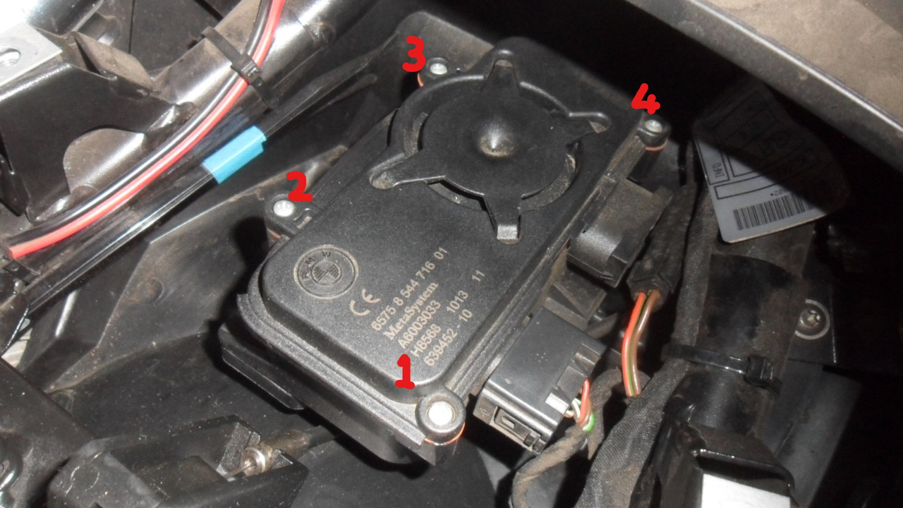

The alarm module will then be just accessible.
l death note wallpaper

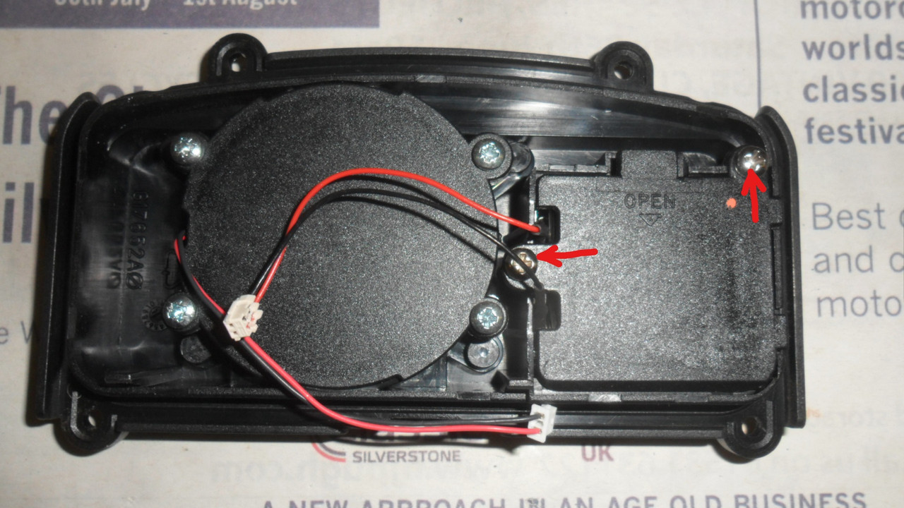

The lid of the module is secured by 4 x PH1 screws.
Screws 1 and 2 can be removed with a PH1 screwdriver.
Screws 3 and 4 can be removed by using PH1 ¼” drive bit and ¼” drive ratchet wrench.
Lift the lid carefully and rotate anti-clockwise. This will release the internal wires and give a bit more to play with.
The twist in the wires is to take up any excess in order to prevent vibrating around inside the module when the bike is in use.

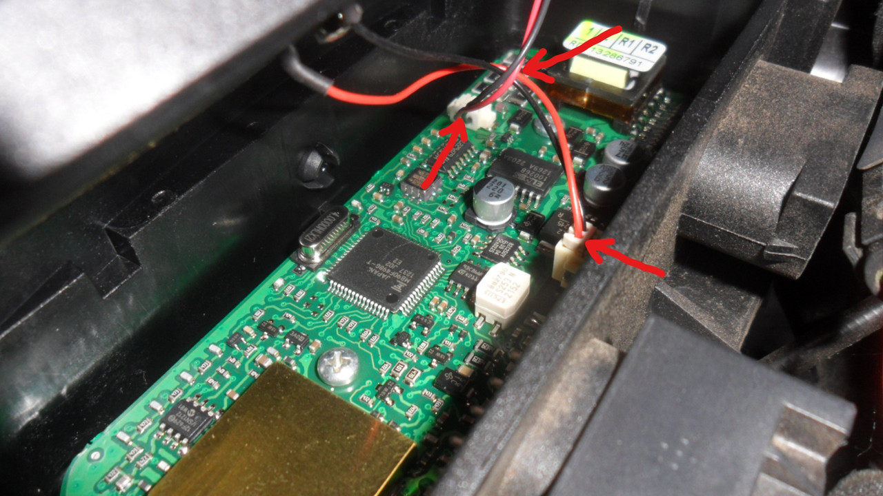

There are 2 connectors that need to be unplugged. 1 from the battery compartment, 1 to the alarm sounder.
Give a short sharp tug on the wires immediately next to the connector body.
Use the Sharpie/ Permanent marker to identify one of the plugs for reassembly.
Lift the lid away and place onto the bench.

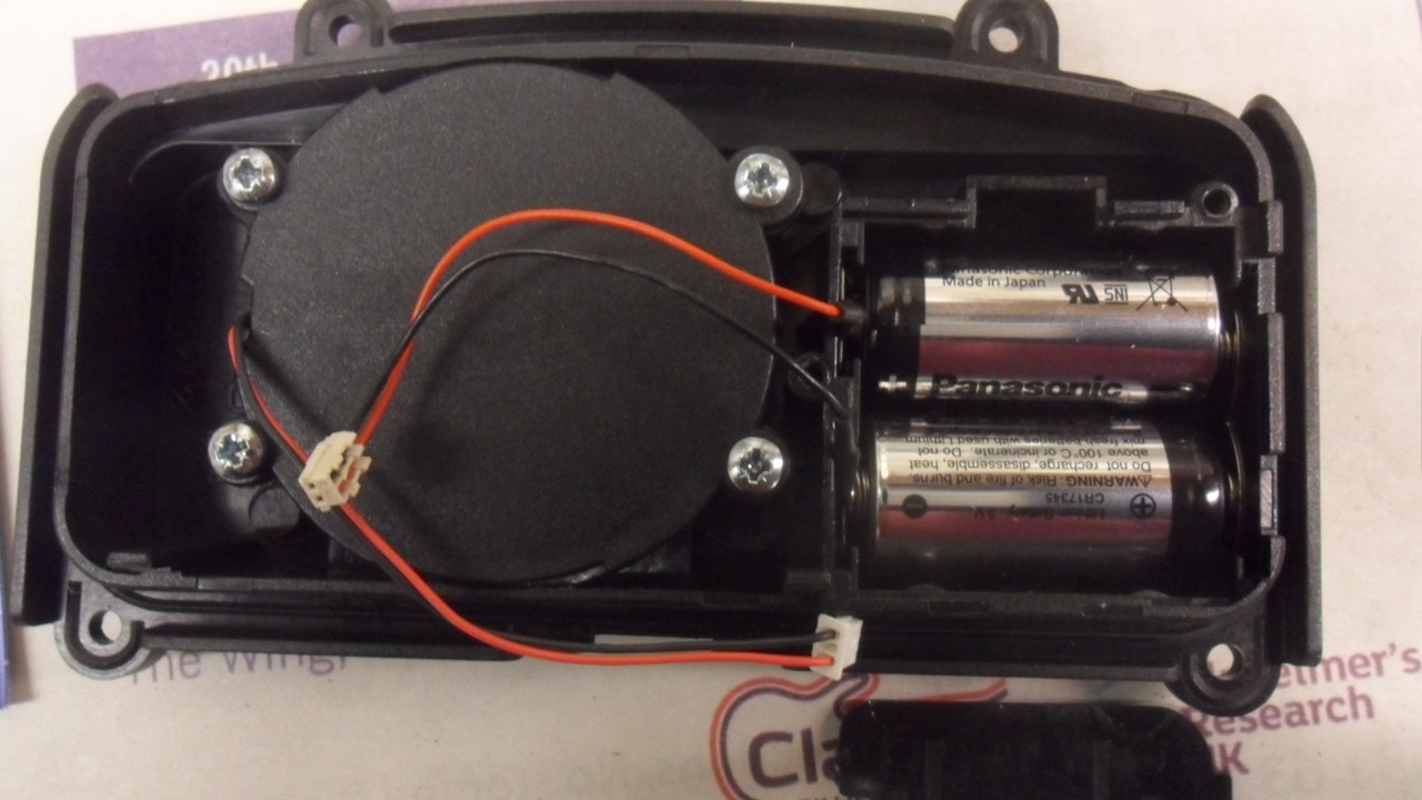

Use the PH1 screwdriver to remove the battery cover.
Replace the 2 batteries.

Refit the module lid to the body. Rotate the lid 180 degrees first. Replace the 2 plugs. Position with your finger tip, and use your finger nail to press the plug ‘home’.
Rotate back to 0 degrees to get the twist back in the wires.

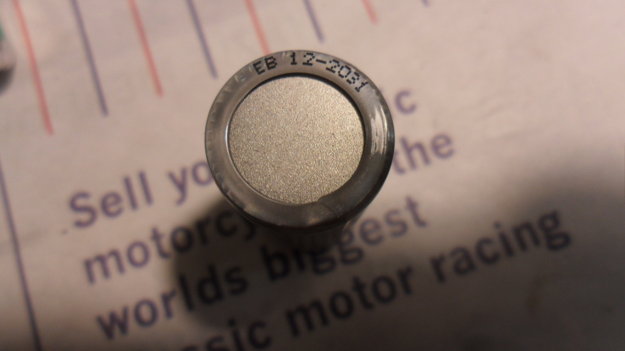

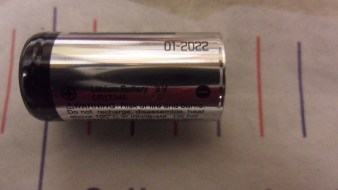

The batteries that I removed had a use by date on them. I wrote this article in April 2022.
The replacement batteries are Varta, with a use by date of:
I have saved this as a .pdf document.

Getting to module screws 3 and 4 is a fiddle, and the unplugging of the 2 connectors, and especially plugging them back in needs long thin fingers. No room to use tools, pliers etc, and too risky next to the pcb assembly.

He said that you needed s long T30 bit to reach the carrier screws, which is not strictly true. You do need a long tool as the standard length bit is too short. The standard adaptor that I used was good for the job.

I chose to disconnect the cover and work on the bench to change the batteries for 2 reasons - a) less strain on the wires and connctors, and b) no chance of dropping anything on the pcb assembly.
