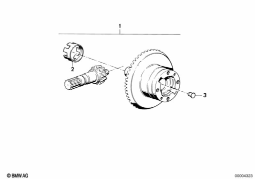

So you say it's the play / tolerance (sorry, I'm no native speaker) between those 2 gears (pic taken from spare parts catalogue for R100GS 1992):
I never ran the engine on the stand in gear yet. But maybe I'll try, just to check if this gives that annoying clatter.

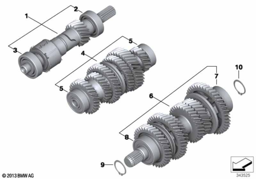

The "cush-drive inside the gearbox": did I get that correctly it's #1 in this image (input shaft)?
According to the mentioned experienced service technician he would also +/- exclude this assembly as origin of the phenomenon (it's not a problem yet, just tedious). But your assumption that several single points add up surely applies.
