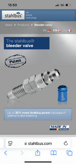

You should probably add a GS911 to your Santa list too - for ABS bleed function. Stahlbus speed bleeder worthwhile too 👍

As long as you get the air out - you’ll be fine without ABS bleed. Speed bleeder is good if doing on your own👍
