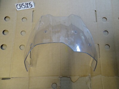

Bit late to this but we have an original F650GS low screen taken off an '08 bike at delivery and replaced with an F800 one. Yours for a donation to Air Ambulance, and possible postage cost. NB: picture shows it upside down.
