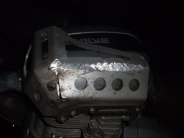

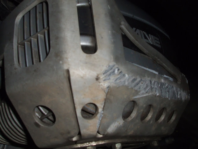

been there.... road polished mine....
is this what you want to see?....
60km/h drop and slide for 30-40 metres down the road.
Having seen a mates rocker cover after he dropped his bike at low speed on a diesel spill in a petrol station and smashed his cover completely, making it unrideable.... I'd say they work as they should!:thumb. They did shave a bit of ally off the rocker cover but that is purely cosmetic. I still have the same protectors and roocker cover on my bike 18 months later ( though i did just about tear it off and bent the shiite out of my handlebar yesterday riding offroad on tourances:blast after rain:blast:blast

The couple of times that mine were tested, they did what they were supposed to do (I do think that the Steptoe version offers best protection though).
They seem to have done their job well, I'm not sure the plastic ones would have made much difference to the state of the rocker covers if they'd have been on for your drop.
