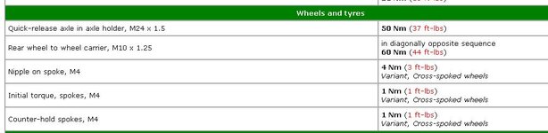

Where have you got the figure of 60NM from?
The 1150 manual has the bolts being initial tighten to 60 then finally tightened to 105NM. I know from your sig that yours is a 1200 but it might be worth checking your info again.
It is 60Nm, see here.
the reason they are 60nm on the 1200 is because they are now a 5 stud fixing
