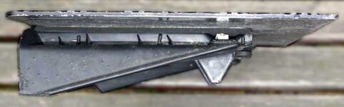

I want to replace my pillion seat with a box (preferably chosen from a selection of different boxes for different purposes).
I asked about this here before (Luggage instead of a pillion seat) and it seems that noone in here has done quite the same thing as RCU.
So I figure my next option is to go to an engineering works and ask what it would cost to make something like this:
But I reckon there are lots of clever people here that can do this sort of thing really well, so I thought I should ask here first.
Is there anyone here who would be willing and able to make a plate (within fittings) similar to the RCU one?
How much would it cost?
What do you think I should get it made from?
Anything else you think might help me?
Thanks.

I adapted the base of a GS pillion seat ( Rainbow gave me one with a torn cover ) a local aluminium fabricators cut me a piece of checker plate for a fiver, which is bolted on using holes already in the seat base using countersunk allen screws to keep a flat surface. They screw into some captive threads from B&Q. As it uses an original seat base fitting or removal is easy. Total cost about eight quid. Will post some pics tomorrow.

View from the side, I put a piece of plastic covered closed cell foam (AKA old mouse mat) between the plate and the base to provide a little bit of vibration damping.

The RCU plate is pretty much what I'm looking for, so that I can stick a variety of different boxes onto it myself.
I definitely want it to extend back over both the pillion seat and the pathetic little rack on the back.
J.T.
Hi, how m uch does the plate thingy cost ?
If someone suppied me with dimensions and how its fixed, i could copy it and make them. Looks about £50 worth to me .
what is it - 5mm h30 al. plate ?
