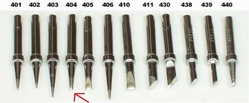

the shape of the tip helps a lot too
i don't like round tips going into a point.... I find they take longer to heat a soldered joint up i find this sort of tip covers most situations
I'm more a 439 or 440 man myself, but yea - dart type tips suck...
