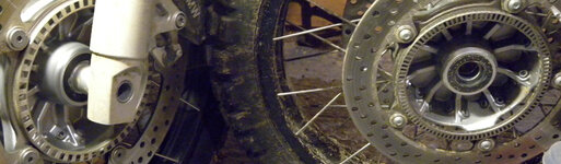

on closer inspection the ABS rings are clearly different ... despits being promised that the wheels were off an identical 08 GSA ...
original on left .... 2nd hand on right ... excuse mud (just dropped the bike in a swamp!)
talonfs ... do you have one like the the one on the left?
