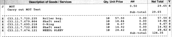

So, going through the history on my (new to me) 2008 GSA
Image below is a scan from a BMW dealer receipt for work done. What are these parts - is it anything to do with the final drive? Would be good if it looked like it had had a final drive oil change. Is there a tool I can use online to type in part numbers and get a description out? Any help appreciated.
Thanks
Thanks for your response. This ties nicely into a BMW inspection report that said "slight free play in rear wheel/final drive bearing" so it looks like the final drive bearing has been changed as a result. I'm assuming it's impossible to change this without also changing the FD oil? Cheer
As said above,these parts are all fd,
Main crown wheel bearing,inner seal,
Rh needle roller and seal plus the housing o ring.
Worth dropping the unit down and checking for pinion bearing wear + lubing the input spline,
As the above parts May well have been changed with the unit in situ.
OK, will put on my 'to do' list for Christmas time off work... my first ever tinkering with a shaft drive.
