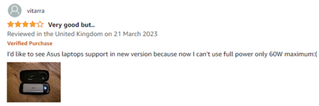

That sounds like utter rubbish.
Well what it actually says is.. that of the 140w you can only use 60w?
that being said the reviewer might be a technophobe.
if it is true then it might make charging a slow process
