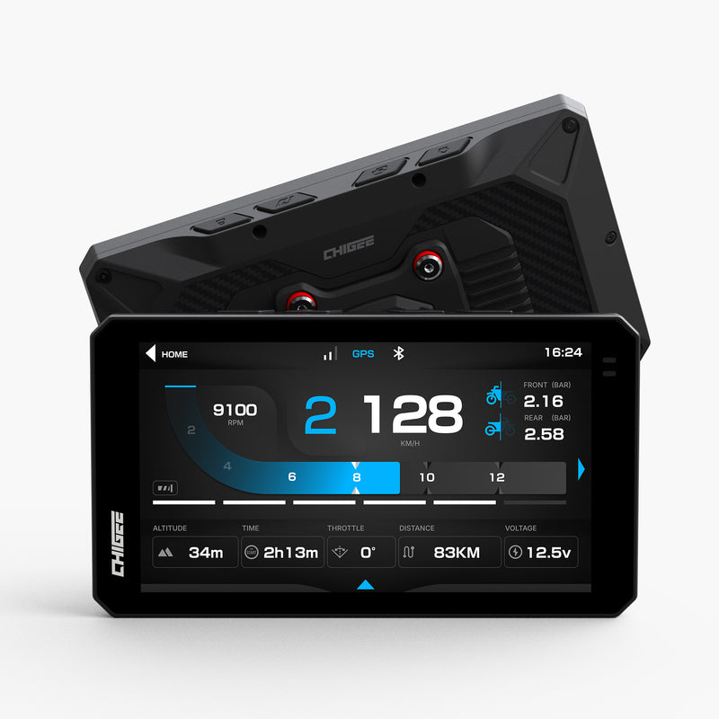

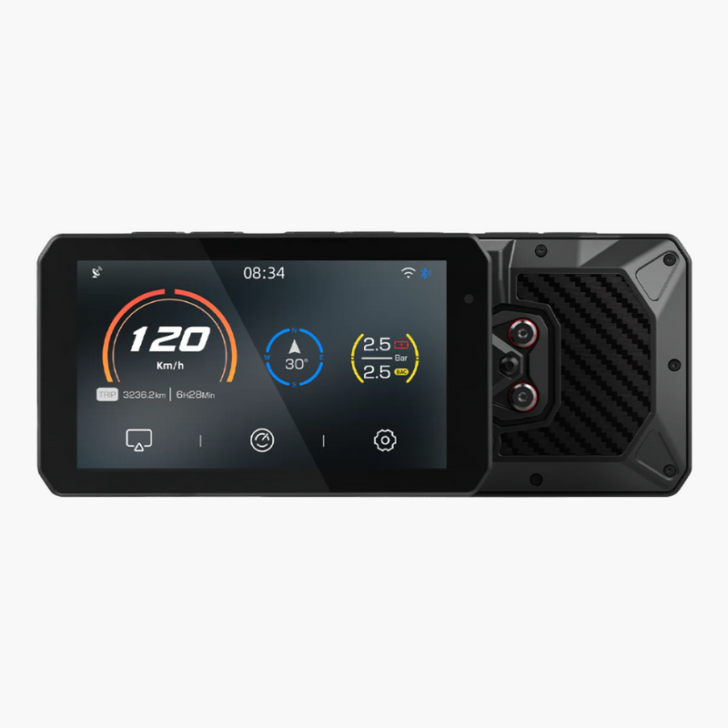

seeing as this is a product many never heard of... its an aftermarket screen to link your phone sat nav - which probably won't get a signal in your pocket if you have a decent jacket
further link beneath the pictures is their support pages for the BMW scroll wheel fitted on LC bikes
the five below says it doesn't work on BMWs " CGRC LIN cannot work with AIO-5 Play For BMW. "
Considerations Before Purchase:
- Before buying a CGRC LIN, ensure your BMW has the 3-pin navigation interface.
- Be aware that you will need to disconnect from the BMW NAV to connect the CGRC LIN to the 3-pin navigation interface.
CGRC CAN: Controls the wonder wheel. (can be daisy-chained with other devices)
CGRC LIN: Controls the wonder wheel + directly reads BMW's Native Data. (cannot be daisy-chained with other devices)
Important Notes:
1. CGRC CAN and CGRC LIN Cannot Be Used Simultaneously
2. Can CGRC CAN be Daisy-Chained?(e.g. Hex ezcan)
3. CGRC LIN cannot work with AIO-5 Play For BMW.
4. CGRC LIN must be connected directly to the 3-pin navigation interface and cannot be daisy-chained with other devices.

For clarification the "CGRC LIN" can be used with the "AIO-5 Play", but the "CGRC LIN" isn't needed with "AIO-5 Play For BMW" as the data comes through the Garmin-derived BMW sat nav interface/mount.
Exactly!
