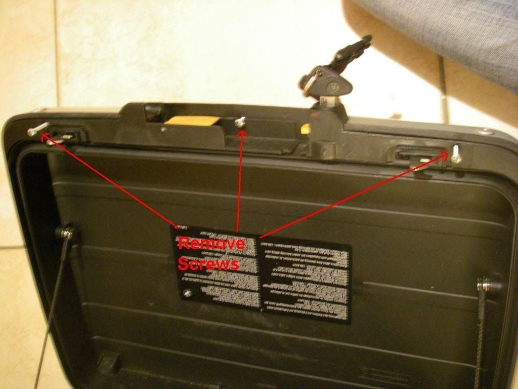

Removing lock barrel from Pannier
Step 1. Unscrew and remove 3 crosshead screws shown below

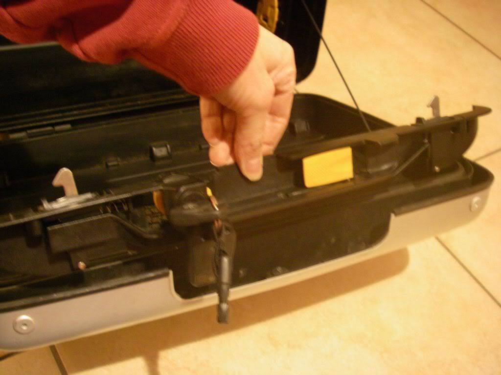

Step 2. lift out entire unit as shown.

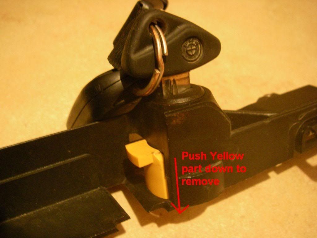

Step 3. With key in locked position remove Yellow part by pushing it down away from the key

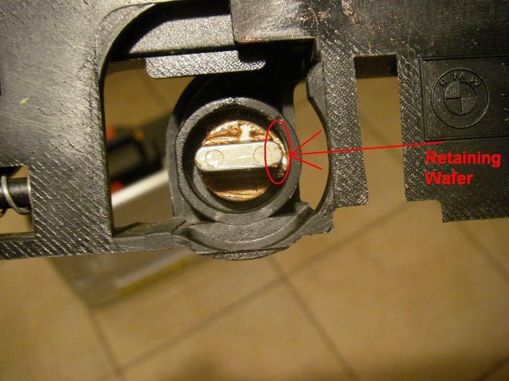

Step 4. Move key to Open position. Using a thin instrument such as a sharp knife, push retaining wafer in towards barrel of lock.
Step 5. While holding retaining wafer in this position push the lock barrel out towards the key.

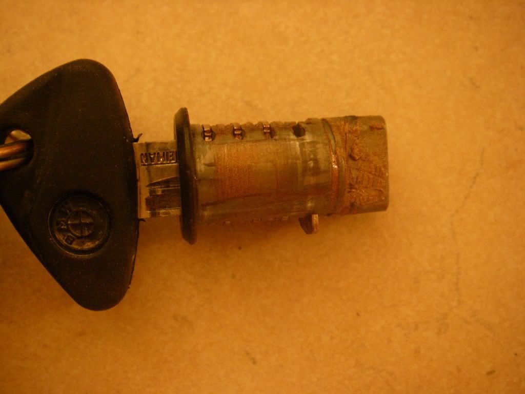

Step 6. Barrel is successfully removed. Wafers or springs will not fallout while key is in place.

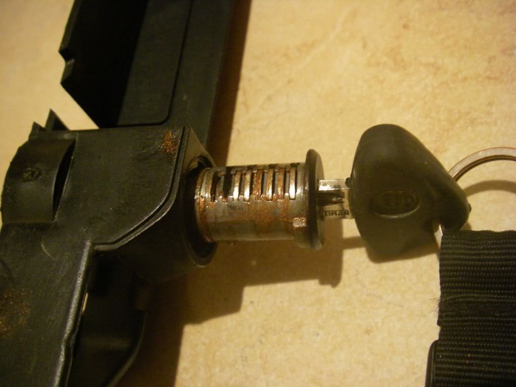

Coding the lock barrel for your new key
Find a bright clean area to work on.
Slowly remove key from barrel. As you do this the wafers will pop out of their flush positions in the barrel.
There are 8 slots for wafers.
The 8th slot is used for the retaining wafer which holds the lock in place.
The 7th slot is not used.
The opening for each slot alternates between each side of the barrel.
Picture below shows how wafers and springs are placed in slots.
Picture below shows wafers removed from barrel with springs still in place.
