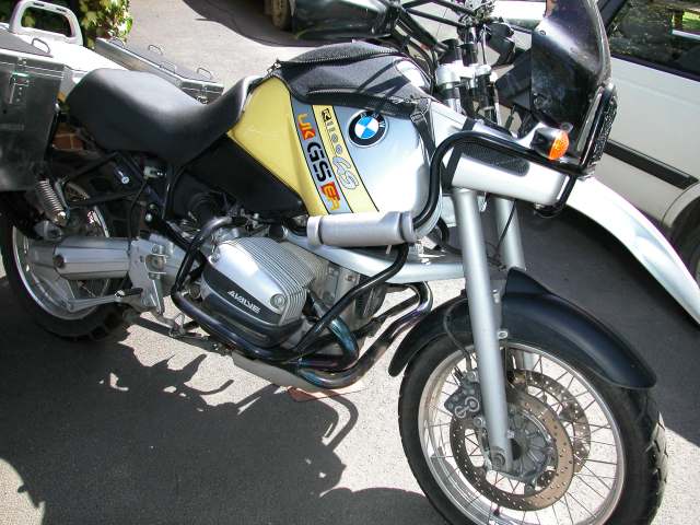

I fitted the wunderlich bars, dropped the bike on it's side (v Embarrassing) while turning out of a car park . Scratched the right head.
Dropped it again off road, bent the bars in towards the right head.
I have replaced them with the H&B bars.
2 Resons why H&B are better :
There is protection on the side as well as front.
They are attached at the rear as well as front.

Bandit forgot . . . H&B bars look ten times better as well.
Simon
Do you have a picture of the more "frontal" area ? ie that area in front of where your photograph cuts off ?
Thanks in anticipation.
Alex

It's an old picture Alex . . . Uncle Gerard has had further modifications since then . . . but it's the best I can do at the moment. Been meaning to take some more pictures for a while.
