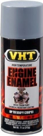

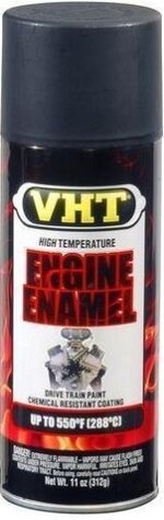

Thanks all for the excellent advice. As a result I'm going to be ready to do the prep over this weekend. I have bought a few things to aid with the job following a helpful conversation with John and advice from GFJ and squibb above.
VHT SP148 primer engine enamel
VHT SP139 satin black engine enamel
Hose clip pliers Clic® Compatible
IRWIN 5 Pce EXPANSION Damaged/Rounded Bolt Grip Nut Remover Set 8-19mm (for manifold studs)
Will let you know how it turns out.:thumb2
