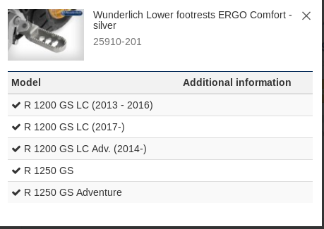

Does anyone know if r1200gs 2006-2012 footbegs have the same mountings as the 2013 onwards r1200gs lc I have seen some lowered pegs but not sure if they will fit my bike they have come of a 2007 gs :nenau
On the Wunderlich website they give different part numbers for lowered footpegs for the bikes up to 2012, and then 2013 onwards, hope that helps a little.
Thanks for the info and have had a look I now know they are different part numbers but unfortunately doesn't help, I am hoping somebody has tried fitting footpegs from an older bike to a newer lc version especially if they had paid £180 for the wunderlich ones
Only thing else I seen is in the part saying what bike it fits, and it seems they must be different as otherwise all the bikes would be in the same list, I imagine.
