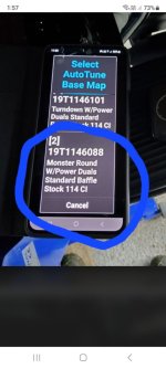

Well plugged it in. :cool: Should I do a auto tune ? Looking on YouTube I presume I leave fp3 on and ride it a few times or is this not necessary 🤔
Bike still starts so I haven't broke it yet.:) Bit unclear what to do if its been plugged in before.
I've never used autotune as the maps downloaded from V&H have yielded the results I wanted. The only "extra" I did was to increase throttle progressively from standard to standard+
However, if you want to use autotune, you need to follow advice like this (stuff on YouTube is easier to follow)...

Ok thanks. I wasn't sure on this as mine has a stage two 🤔 Screenshot_20230731_135750_Samsung Internet.jpg
You're in territory where I have not ventured However, Google searches reveal that many have with good results. Here's one guy's experience from the Road Glide forum which shows that contacting V&H is an option:
"You don't have to stick with their 'canned map' as you keep mentioning. Usually, those maps are used as a base tune. Afterwards, you can run an Autotune cycle and it helps to smooth out all the rpm ranges. Also, you can further adjust throttle response, backfire (some people like decel pops), and other adjustments.
If you don;t like the results of the Autotune, you can contact V&H, upload your chosen tune, and they will revise and 'tweak' it for you, send it back. All this is done on through the App and mine was done within a day."
