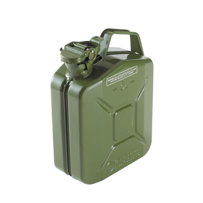

Not sure about underneath, but you could fix a shelf to the front or back of the panniers and strap one or more of these. It carries 5l and they do a 10l version too.
5037151009953_001c_v001_ap
The dimensions are about the width of a standard pannier.:thumb
