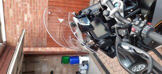

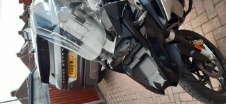

I am a big fan of the Givi Airflow, however I could not get one for my R1250GS so I made my own polycarbonate "lower screen" and added the Givi upper screen and fittings along with aftermarket screen supports - it works a treat. I am thinking of selling just the lower screens on Ebay.

Pics
I shall making another one as I managed to scratch this one. Also I want to chamfer the edges

I had Givi Airflow on many of my previous bikes and it always worked well. On my 2021 GS, after spending money on few screens and spoilers that didn't work (buffeting problem, not wind noise), I decided to make my own Givi Airflow one year ago. So I did it, just like OP had it done. But, it didn't work. The buffeting was a bit better but not solved. So, it was no joy for me. I even tilted all kit towards me by making lower bolts spacers (and new bolts). It was again just a bit better but not solved. Eventually, I solved it with keeping the spacers, installing Wunderlich Marathon screen and adding MRA spoiler on the top. Tested it at max speed and have zero buffeting now.

The only thing i would add, is the original Airflow needed to be braced, as it's alot of real estate to mount on the std fixings

I originally modified an XT1200Z Airflow lower screen by cutting it to the same profile as the bottom of the R1250GS screen and it worked very well, however the screen was made of Acrylic and the holes I drilled in it enabled cracks to appear shortly afterwards. I designed this latest screen to have the same profile but now I laser cut the profile before moulding to shape, I also use polycarbonate so it is unbreakable.
