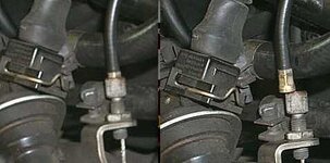

I had the tank off and at a strange angle (but left the fuel hoses attached all the time) to fit my autocom.
Having put it all together again the bike wasn't very happy to start, and would barely tick over. Then when i tried to ride it, it was difficult to pull away without stalling. After much clutch slipping i was away but the bike wasn't pulling right and as you give it a large handful to try and get it to shift very little happens and then suddenly it kicks in with full power and you nearly fall off the back. This happens in all the gears at low revs, at higher revs it seems more normal but still not running smoothly.
My first thoughts were that i had crimped a fuel hose, but i hadn't. So my next thought is have i got an air block?? Otherwise maybe i accidentally knocked loose some of the wiring under the tank but i dont think this is very likely.
Any thoughts on what the problem may be and how to rectify it would be much appreciated - I'm sure its to do with my installing the autocom so must be easy to fix.

Andrew,
have a quick look at the cables where they go into the throttle bodies. I think you'll find one cable (probably the right) out of its sleeve. Simply replace it and it should fix the problem. If it isn't that, re-post....
MikeO:)
...exactly right, although the throttle body doesn't always go out of focus as you replace the cable....

Thanks everyone who replied so quickly,
I can't believe that adjuster made the bike run soooo badly.
Anyway that was it so the trip's back on tommorow.
