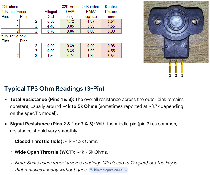

my bike with this pattern motorworks TPS unit is unrideable
their claimed fitment includes both bikes - but they list a different BMW different part number which supersedes the original all my bikes had...
So just pulled off a 10,500 mile old TPS from my 2011 GSA Twin Cam - all three OEM BMW ones have the same part number from years 2006 to 2011 and measure closer to each other than the pattern one
2011 Bike in Blue

I was checking in with a control tech mate... and he's all over it as usual. I now don't think the later TPS is an issue
4K sensors were an earlier design, the voltage the engine ECU gets is the same, but the 4K ones wear out faster... Hence why they were superseded
The slight variation across the board of all the TPS sensors I measured isn't a big deal and he doubts any of them will cause issues if things are set up correctly...
The values I have measured on all sensors look normal - but the reference values (from a table off this forum) fully anti-clock are gibberish, this type of sensor can't do it
TPS sensors of this design can wear on the wiped face, and or get dirt or tarnish build up. He gave a perfect example of tarnish, when you hear the crackles as you wind up the volume on your amp. As you wind the volume knob back and forth, the crackles vanish as the tarnish disappears and it all goes quiet when you turn it once clean.
He is on the page the bike must have its adaptions wiped - so it can start to build a new world based on the values a specific TPS is bringing to the party.
As he says, at such tiny throttle openings the difference in air flow between one smidge of throttle and a tiny bit more is so huge the variation in fuelling the engine ECU needs to control is significant. And thus a small variance in manufacture of one TPS to another will signal wild changes to the engine ECU if we just swap them out willy-nilly. So when I swapped out the sensors and rode off, the bike has no idea the TPS was changed - but the values the different TPS is now sending to the engine makes the ECU think the throttle is far more open or closed than it was vs the other TPS, and its offering very different fuelling characteristics as a result.
And with that in mind, any slop in the spindles of your throttle butterfly's will create a similar crazy random air flow for a given TPS reading
And making that all land true - I rang motorworks to ask about things (before I got my head around the fun or discussed with my neighbour), and they confirmed they have a lot of issues with owners not liking things when they've swapped out a TPS
There is a lot of misinformation about if or isn't there a new TPS set up procedure - before wiping engine adaptions and starting over you may as well try this

Here is what my engine adaptions did when changing the TPS temporarily - before doing this I checked the bike was happy and that both lambda sensors were behaving (before and after)
