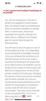

How does it work if you have gloves as well, does it mean the gloves and jacket have to be the same setting? Also my gloves have separate heat controls on the cuff, so the only way the Hexez can be working is by reducing the current flow to the jacket, so can't see how it will work with multiple heated gear with individual controllers. My jacket controller reduces the current to control heat, so does the Hex alter the settings on the controller, or do you now have to have a direct connection, taking the controller out of the circuit? Sorry for all the questions, just can't see how it works with a controller in line and multiple gear :)
For the jacket you remove the inline remote and replace with the small wire that would have come on the jacket when bought. Basically removes the remote. Then you take the power wire from the jacket and run it to an ezCAN extension. Now you are wired direct to the hex device for power. In the hex app when I knock on my grips to power setting one I get 40% heated then power setting two I went for 50% heated etc etc. Its adjustable on the app.
Ive not tried two heated garments but Ill give it a go over the coming days.
I wonder is there a way to take the switch out of the gloves etc, In theory you could remove the switch and do a wee bit of soldering to allow the gloves to be always on (if that makes sense).

yes you could run it independent of the grips, it gives a long winded way of doing it , pic below with the details-basically set them up using a separate circuit on the hexcan
