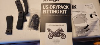

I bought this kit from them but the location of the loops were still a bit out for my needs. It places the bags farther back to keep the seat clear, not an issue for me.
https://kriega.com/sports/touring/bmwr1250gs
Kriega are only 18 miles from me so I called in and got 4 extra straps, which they gave me for free so I could keep the fitting kit complete

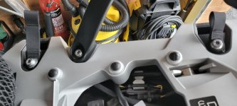

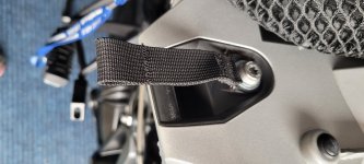

2 x 50mm bolt-on loops
2 X 65mm bolt-on loops

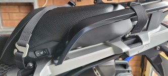

These worked out perfectly, shorter ones on the rear to avoid the aluminium hook touching and the longer ones on the front. Work great with either a US10 or 20
Washer inside the fixed to bike loop. Stay on all the time. Rock solid and easy on/off
Doesn't interfere with the vario cases
Was just trial and error

If you ring them, they are based on Deeside Industrial estate, near Chester, they may send you 4 of the straps as in the kit
Find 4 suitable bolts on your bike to fix them to...maybe easier than buying webbing and having to get a loop sewn
They has different lengths all stored in a massive wall rack in the stores, so they are available to them outside of a boxed kit
