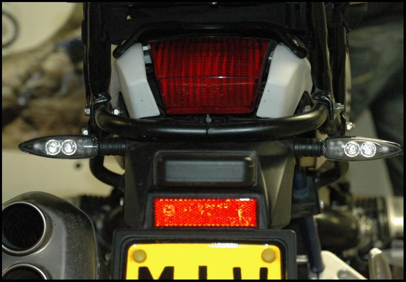

I've got the BMW LED blinkers on my 1200GS - straightforward replacement, no workshop time needed.
<a href="http://www.flickr.com/photos/davedyer/2924942220/" title="08/10/2008 bmw led by Dave Dyer, on Flickr"><img src="http://farm4.static.flickr.com/3104/2924942220_97cf6acfbf.jpg" width="500" height="375" alt="08/10/2008 bmw led" /></a>
As you said : you've got a GS
I had to do some work myself because the connectors are not the same on the MM.
Just bought the blinkers and spent some time in my garage.

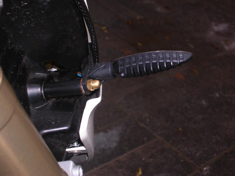

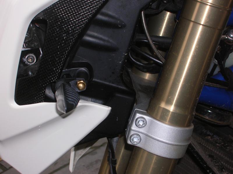

Front blinkers are too short of about 35mm so it obliges to imagine a system to fix them.
so what did you have to do to make the fronts work if they were too short?

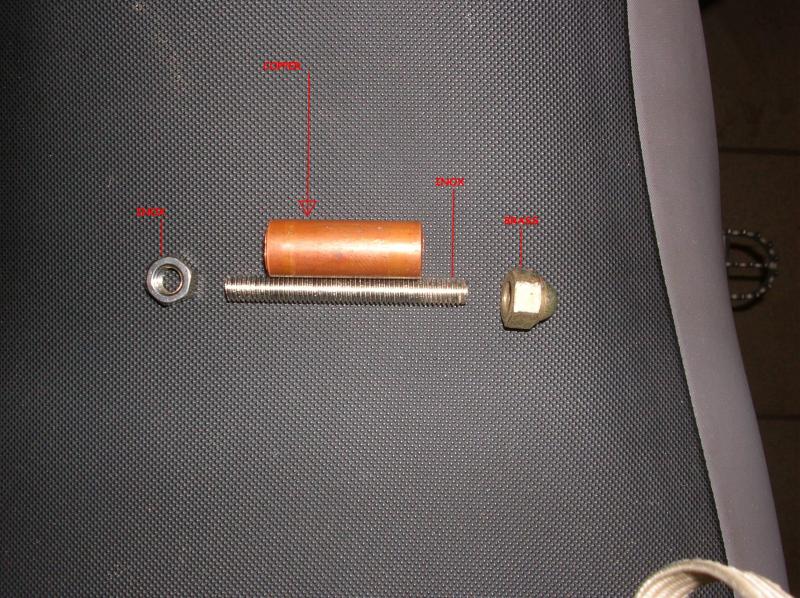

here it is.
Copper tube is 40mm long.
Brass nut and inox bolt.
Blinker is now fixed only by 1 point.
Nice job. I'm surprised that BMW don't provide the appropriately shaped LED blinkers for the HP2 - it seems that while the actual LEDs are the same, the stem and mounting parts come in various shapes and sizes to fit the various bike models.
Thank you for the kind comment !
But my dealer also rides a MM and hasn'f found the model
for it on the official listing :nenau
So, I had to imagine that simple mounting which permits the front blinkers
