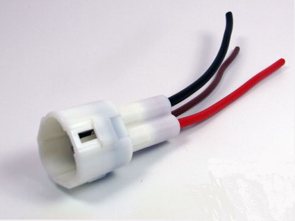

This is what you need. Might help distinguish the correct plug too. IIRC it has a blank plugged in that can be binned.
