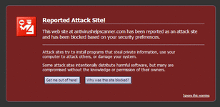

It's a browser hijack Greg, not a virus.
Run adaware instead.....that'll root the fekker out :thumb2
PS The second link should give you this if you're protected by something that works ;)
(It'll probably be a trojan/hijacker in the first that installed the hijacker in the browser though)
