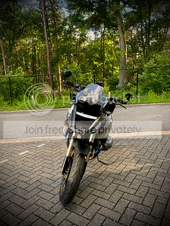

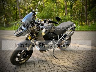

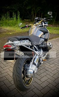

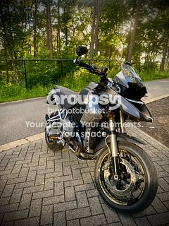

Hey mate, that looks amazing. I'm planning to do the same with my BMW R 1200 GS 2011. Do you have any tips and tricks for me? I'm especially still looking at how I'm going to solve the front mud guard. Did you modify the existing one? Any manuals that I can find online for that?
Currently, I'm following the tutorial that I found online:
I'm planning to use the R1200R rims for an easy bolt-on solution. I don't plan to have any issues with clearance, but any tips you might have, I'm happy to hear.
Did you use the standard handlebars, or did you change out the handlebar to something else? I saw people changing it out for the R1200R handlebar?
Quite a few conversion I’ve seen use the oe mud guard and use spacers to sit the guard closer to the wheel, I can’t remember where I got my mud guard from, I fitted carbon bst wheels.
