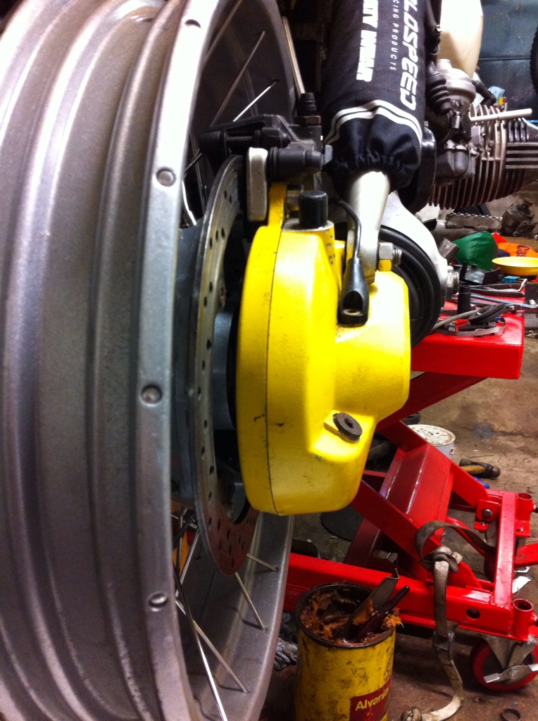

I lashed one up a few years ago with a view to fitting a 1100 swinging arm into a paralever frame. The 1100 swinging will fit straight into the mono frame but needs a spacer to fit in the paralever.
As mentioned above the biggest problem is getting the wheel to sit central in the frame. You need to have the wheel laced with a huge offset and there's only a few places to get this done. Woodies wheels in the states and somebody over here I believe.
Ive heard the 1100 bevel is narrower and obviously comes with the disc mounted to the bevel drive instead of the wheel making things easier but you will then need a narrow rim fitting to the bike
The downside of this is you end up with a pretty big cumbersome bike with lots of compromises and a low powered engine and limited steering lock unless you buy expensive yokes to give an offset but then you compromise the steering.
Id buy an africa twin and just ride it :-)
Picture below showing the offset. I dont think you can completely eliminta the offset just reduce it.

Daithi who used to frequent the forum did it with a K100 back end and a respoked rear wheel by Hagon I think he said Wheel had to be spoked 20mm toward FD
I know it's an old thread but I thought Id better reply.. it was 25mm offset, big chunk of the hub showing from the rear...
