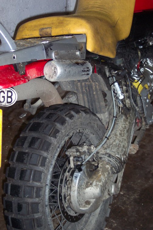

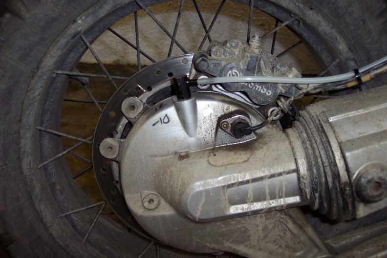

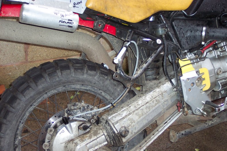

I've been playing around making a breather system for the bevel boxes and so far have come up with this.

I haven't finished it yet, it's going to be dual purpose you see. I'm going to put another inlet on it, for the crank case breather to fit, if you don't want to do that, I'll sort blanking plugs out for you, that way, you can do the crank case at a later date. Oh yes, you'll have to drill a couple of holes in your bike as well;)
Interesting. Is that 4/6 MDPE delivery tubing? Got about a thousand metres of that kicking around at work and in my garage...
Why such a big box/bottle on the end of it? Don't think I could mount something that big there, as the pannier mounts would be in the way. Still interested, though.

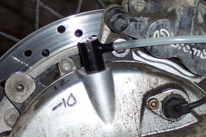

I'm on the Mk3 already, I thougt that one was a bit naff, the Mk2 had the breather straight out the top of the bevel box, which was hard to tap in, and now the Mk3, has a stainless boss, with a 90degree elbow on top that screws in.
It's got a bottle that size, because it's going to share with the crank case breather, and needs the extra volume to be able to cope.
Peter. I'm waaaaay ahead of you on that one, it's got enough clearance to so you can still fit standard panniers, and mine, but I'm not so sure about all the other after market stuff.

I run the pipe up to the top of the battery under the tank, if I get water in at that level I'll be worrying about something else other than the bevel drive box.
