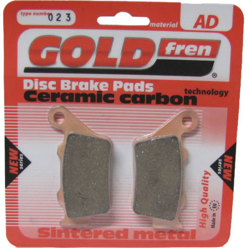

Just removed pads , rear from my Dakar F650gs. They are Goldfren KBA 60878 HH, stamped on back, best back brake ever had. All I can find are ceramic carbon versions AD? Not HH . They may be 10-15 years old. 023 appears to reference size/shape on type no. Can anyone enlighten me?
Would love to buy originals
I've used this company before and had no problems..
