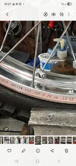

When I rebuilt my 88 R80GS I installed these angled units, as it makes tyre inflation so much easier.
From memory there was a wee O ring on outside.
I applied a tiny bit of black silicon to O ring before tightening nut.
Never had a problem with front or rear....Screenshot_20251122_192714_Gallery.jpg
Never had a problem with front or rear....View attachment 461322
