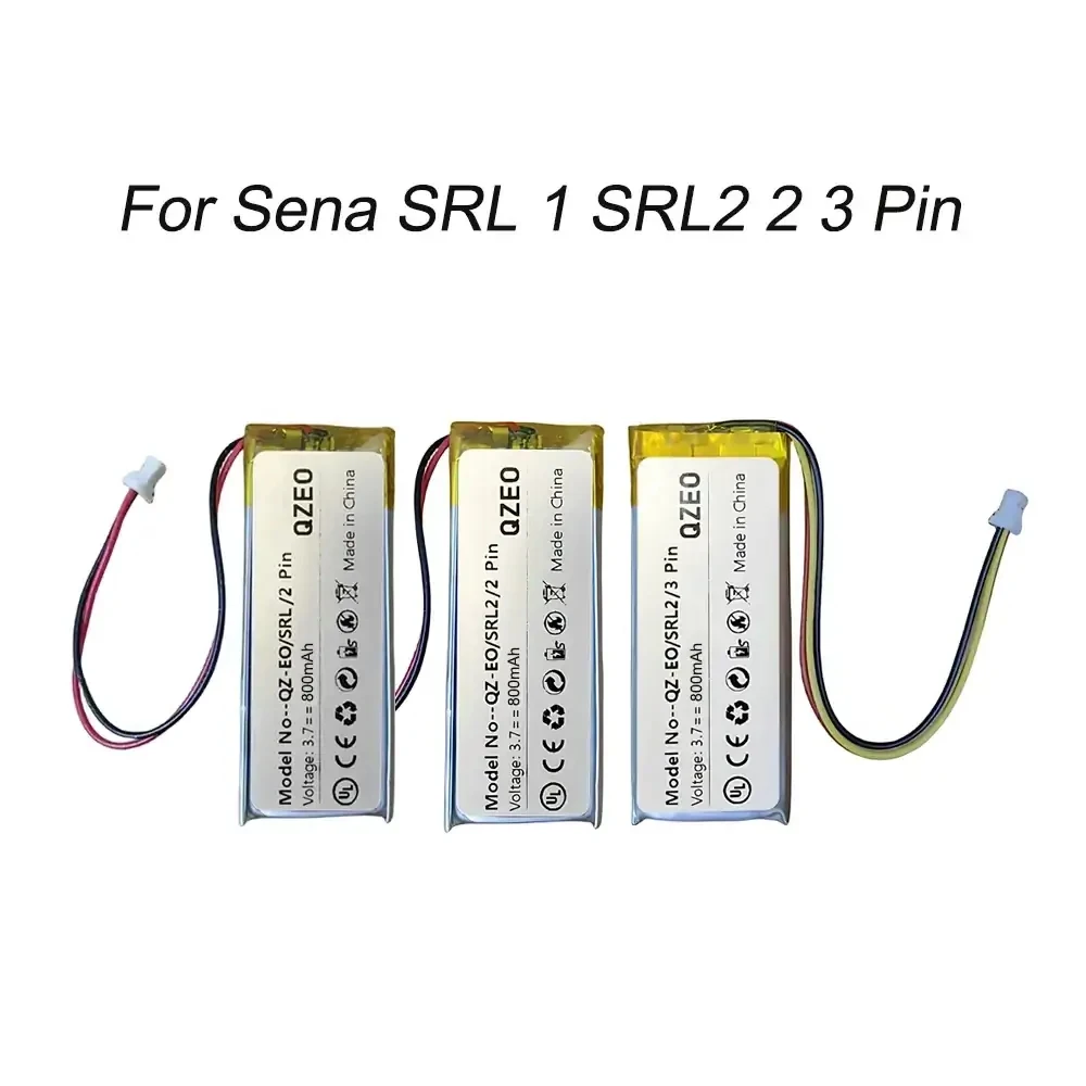

Hi all
Has anyone replaced the battery in a Sena SRL 2? I need a battery pre fitted with a 3 wire harness, but all I can find in the UK are 2 wire ones. I’ve found 3 wire variants via Aliexpress, but the reviews are mixed and air more towards negative than positive.
TIA
Mark
This has only 2 positive reviews but at £7 shipped I probably wouldn't be that fussed (you have to select the 3 wire option)
From looking into the details a SRL 3 battery would fit and has slightly larger capacity, seeing as they fit the same helmets whether 2/3/mesh
Cheers @Bigcats. I did see that, and may order one.
I found some online advice on resetting the battery (can’t for the life of me find it again), which involves partially discharging the battery, then disconnecting it and leaving it disconnected for a couple of hours, reconnecting it and leaving it on charge overnight. I carried this out last week and it seems to be playing ball. Went out for a good 5 hours a couple of days ago, and no low battery messages and it was still showing full when I checked it post ride.
🤞this has sorted it.
Update on this. It’s now been three weeks since disconnecting the battery from the circuit board for a couple of hours, and all is still good. Even after the headset being in use for a good days ride, no low battery warnings have appeared.
