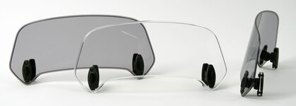

Hi,
Going to buy a wind deflector/spoiler thing for my new GSA screen.
I see there are ones with a single centre fixing and some with 2 fixings.
Any thoughts ??
Does the single point one get in the view point?
Thanks for any help.

I have the dual one. Better than my previous solo one.
The one shown on the lower photo looks to be the type which will needs holes drilling in your screen. If this isn't something you want to do ensure you buy a clamp on version
If you’re going to drill your screen, put some masking tape on, over the top so it covers both sides, and drill through that. Sharp drill, not too fast, and don’t press too hard.
I have used both types, the single bracket type, cheap off ebay or aliexpress, can't really remember, but for me, the central bracket did slightly obscure view when looking down through screen.
I now have the MRA X-creen, excellent bit of kit, dramatically reduces wind noise and buffering, have it pretty much vertical on motorways and less so on the twists, I also made sure I ordered the clamp type, but to fair it came with both. I have also added stabilising clamps, to make screen a bit more rigid. not expensive and super easy to fit.
this sort of thing,
https://www.ebay.co.uk/itm/30402912...6&customid=vxrLl0cWAAAANA-CBgahEgdsTokIAAAAAA
I purchase the double. Mine had adjustable arms and clamps rather than having to drill screen.
Aliexpress.
Cheap.
Works great.
Did need to buy stabilizer arm also.
