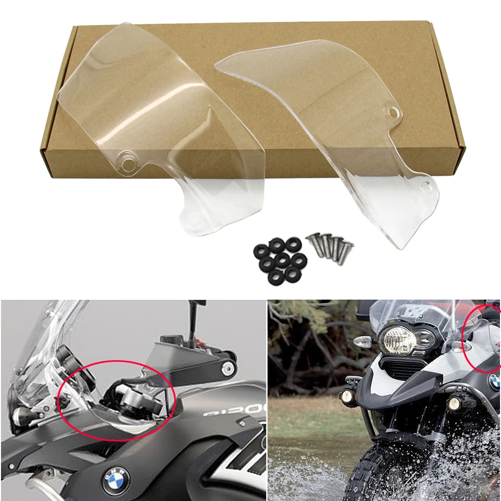

I have a 2010 GS and am going to fit the BMW Adventure slipstream deflectors. Seems Motobins stock the genuine parts with one exception. Some sort of M5 nut is required but for the life of me I can not find it in any of the microfiches.
I know that the earlier bikes had a different frame under the bodywork and required an additional mounting arrangement but my 2010 GS has the same frame underneath as the GSA, I can clearly see the frame with the two holes for the attachment as can be seen in the attached image.
Any ideas folks, guessing it should be some sort of captive nut.
