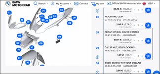

I’ve only been out twice since fitting the headlight protector…. the offending pigeon didn’t fare so well..🥲.
I’m very glad I fitted it… but as you’ll see from the close up, it was enough of a clout to crack the fairing underneath the light. Can anyone help me out with the following? Is there any kind of “invisible” plastic repair service or am I looking at a new piece? If it’s a new piece required, any idea what the part itself is called?
Thanks in advance ..
Craig, go onto YouTube and search invisible plastic repair, there are plenty of videos showing you how to do this if you fancy having a go yourself. Or, contact companies who deal in second hand BMW parts such as Sherlocks, MotoBins etc for a used replacement.
Or leave the damage, feathers and all and look like a rufty tufty GS adventurer :D
