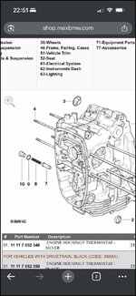

Hi all,
As part of my strip down I removed a plug on the lower-right of the crankcase - the plug/cap was in an awful state and needed replacing.
I knew it was a tensioner when it came out, which poses two questions…..
1. Is it for the auxiliary drive shaft chain? parts 10-7 below. I’ve looked through the service manual and can only fine one reference to it (same page as sight glass replacement irrc!)
2. Do I need to take the front crank case cover off to check whether it will have dropped a tooth, and therefore need to realign everything, or should it be ok? The engine hasn’t been turned since it was taken off.

It’s not a tensioner, it’s an oil pressure relief valve.
Check out the diagrams concerning the oil system.

it’s not mentioned in any of the servicing manuals, but is is referenced in the OEM oil system along with the oil temp bulb.
View attachment 459518View attachment 459519
Thanks for sharing that Ian. That’s my point - I can see it on the parts Fische, but the official BMW repair manual doesn’t even say what it is. I’m looking for what it is and how it works - the manual should show me this.
I can’t think of any reason why it wouldn’t be in there! Crank case…oil system…both would be useful places to put it.
So, I’ve removed it. How do I tell if something may have dropped inside the crank case as a result?
The spring on the piston controls the oil pressure. I guess it’s not referenced anywhere because it never fails. Any oil pressure problems are most likely due to oil pump failure or wear.
