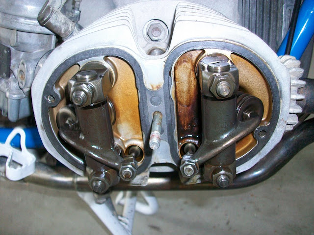

when do I replace stem seals?

Checking the valve clearances I thought that there is quite a bit of burning showing at the exhaust valve. is this normal or should I replace something? (it was looking even a bit worse, had by photo time run my finger over it)

Looks ok to me
I know it's a bit sad but you can see how much hotter the exhaust ports run compared to the inlets on my PD so a little extra oil deposit is normal - the hot spots match upto the darker oil areas on your head.

I'm in the middle of the winter o/haul and due to time restraints I'm well behind. I was looking to replave the exhaust valves as I dont know how many Killometers mine has done. I rang motorworks to discuss what bits to order and they told me one way to see if the exhaust valve guide was cream crackered was to look for.......evidence of oil burning on the top of the head. I'll check mine this w/end.:blast
this might help sylvester http://jhau.maliwi.de/mot/head.html . also some good videos on youtube if you do a search. I reckon if you are going to trouble of replacing valves you should check the guides for wear as well and replace if needed. In one video http://www.youtube.com/watch?v=33gSLM2CcpM the mechanic checks the cam followers and finds them pitted so it would seem to me that you might as wel check all is well right down to the surface of the cams.
Took one head off today and I had no burt oil deposits as shown on Newguys bike, so if I were you NG I'd check the valve guide coz mine was buggered:eek:. Managed to get the offending item out so will be on the phone to motorworks tomorrow for replacement bits.
