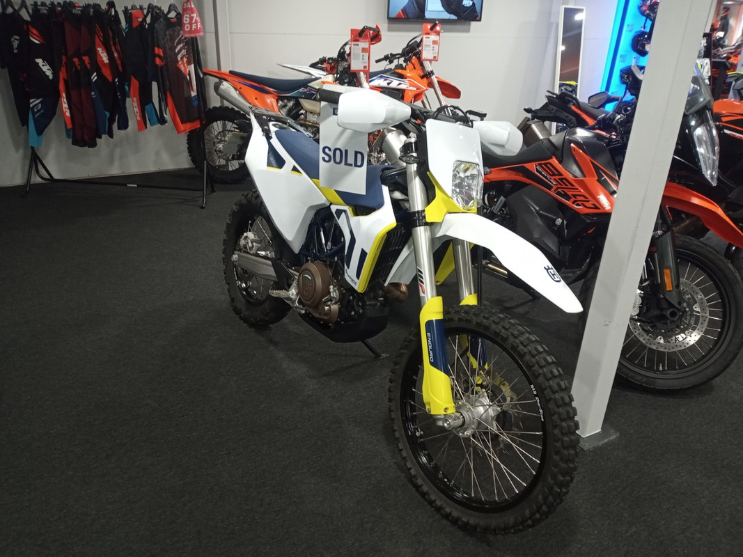

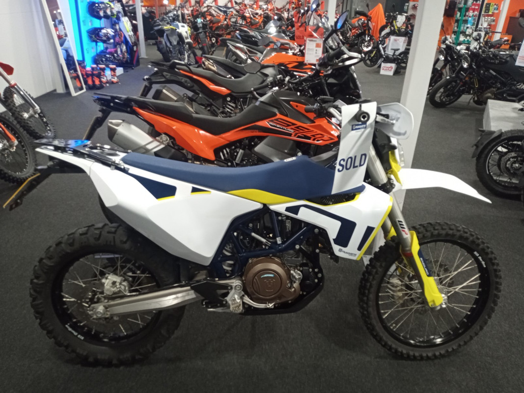

Deal done on this 2021 bike from Judd Racing - should pick it up next week :D
Good choice, I also tried to resist, but knowing that a mate lent me his, laughing as he said that resistance was futile - Mrs GSite says he is a bad man (for the bank balance at least). Enjoy.
