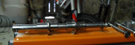

Its what I did. Kept the standard bearings and had an axle and spacers made up to keep it all in line.
Disk on the left fork.
