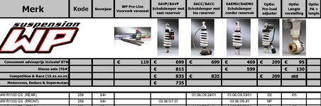

Just been quoted € 1422 to have WP Suspension fitted on my 1100. Thats about GBP 950 in old money. This is for the BACC unit (model nr 01.06.08.24)on the front and the BAVP (Model nr 03.06.07.37) on the rear.
There is a cheaper option which is about 2/3rds the price but they tell me it offers less adjustment possibilities and if I am considering any off roading then these are the ones to go for.
What's the consensus on WP ? Are they worth the money or is Ohlins the only way to go ? How does this price seem ? It seems expensive to me but I haven't ever bought these before so what do I know ....

First thing I did on all my previous gs'es was replace the rear shock for a wp.. They're good, as good and as pricy as any Ohlins or Technoflex.
On my 2 1100 gs'es and my 1150 I had a BACC 01.06.08.24/01
shock with a bit heavier spring (+50kg) and even 2up on Iceland
and on Scandinavian gravel/mountain tracks it worked fine.
Only disadvantage was the amount of work to adjust the preload,
you can't when the shock is built in.
