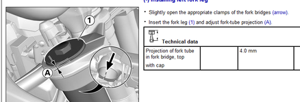

I've noticed on my 2010 F800GS that the height of the yoke looks as if it's been lowered by the previous owner. I want to put it back to standard but I'm not sure what that is. Nothing in the owners book about this and just wanted to ask if any one here has any info.

4mm latest model 3.9mm earlier ones
Your bike has also got spacers to raise the handle bars fitted they are also not standard
Mine has a line machined into the barrel.
To be honest "standard" is irrelevant. It's what you like with regard to speed of steering or bike height that should determine where they are...
