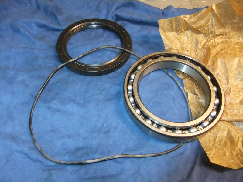

The parts needed are minimal: A new bearing, main seal and O-ring:
These are not hugely expensive and you may not need the O-ring as it sometimes survives the process.

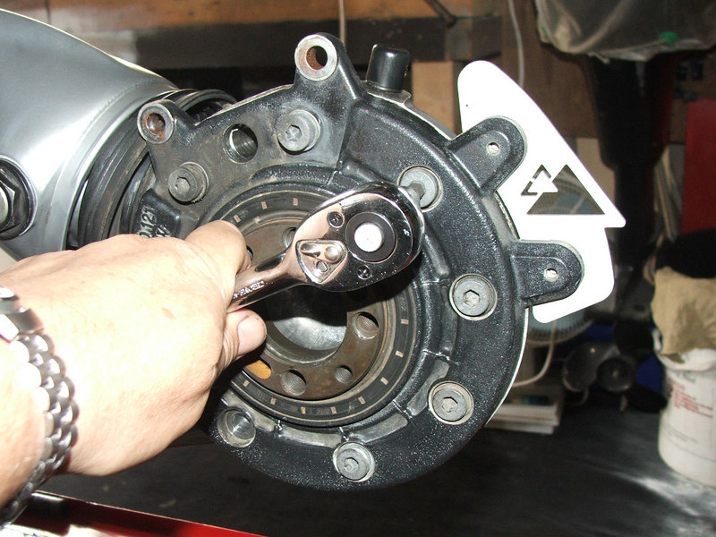

Now do the heat thing again for the eight hex-screws holding the F-D cover plate (these are not secured with Loctite but they are steel into aluminium and may be reluctant to move - heat will help break them free):

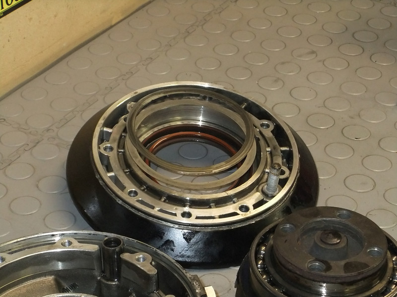

If the cover plate doesn't immediately come away (with the Crown Wheel so be aware that it is heavy) you will have to separate the two halves. Be careful, the O-ring is in a recess in the joint. Often after years the O-ring is past it so it's best to have one to hand. A broad screwdriver will work to lever the cover off.

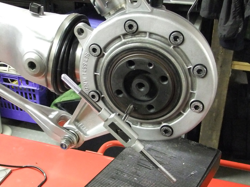

Normally the final drive housing comes apart fairly easily with a few taps from a soft headed hammer on the caliper mounting lugs.
However, if you have one that is really stuck, then be aware that the bolt hole opposite the caliper lugs is tapped M10. A 10x1.5 mm bolt in this hole will gently jack the two parts of the casing apart, with a little help from your soft hammer on the lugs. (I cleaned the paint out of the thread to make it stand out on the photo)

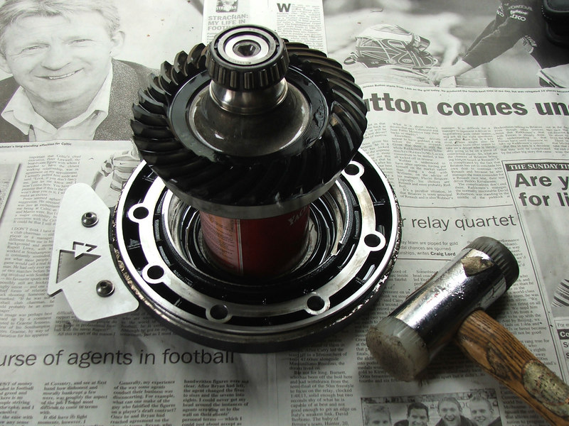

The Crown Wheel will most likely come away with the cover, held by the seal. If the Crown Wheel is reluctant to part company from the seal and cover plate, find a paint tin of a slightly smaller diameter, place the whole thing centred on the tin and press or tap the cover plate downwards:

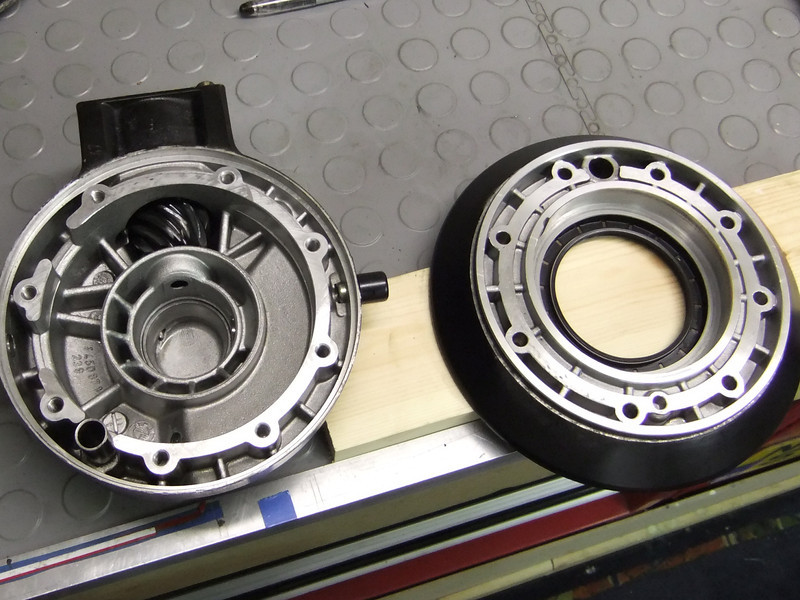

As the Crown Wheel separates from the cover plate you will probably find one or more shims between the Crown Wheel and the cover plate (K75C drum brake model housing here):
Now this may cause some debate: There are videos of how to re-shim the F-D. Unless you are replacing the cover plate there is no need to re-shim. The shims are to deal with variations in the cover plate and F-D housing and not the bearing. Simply replacing the bearing needs no re-shim. Any bearing set that is so variable that it needs shimming isn't worth fitting.
It doesn't matter what order the shims are in. What matters is that they are there and that you put them (all) back when you reassemble things.

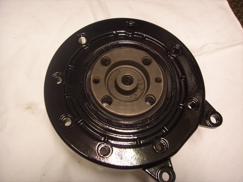

Take this opportunity to clean both the cover plate and the F-D housing.

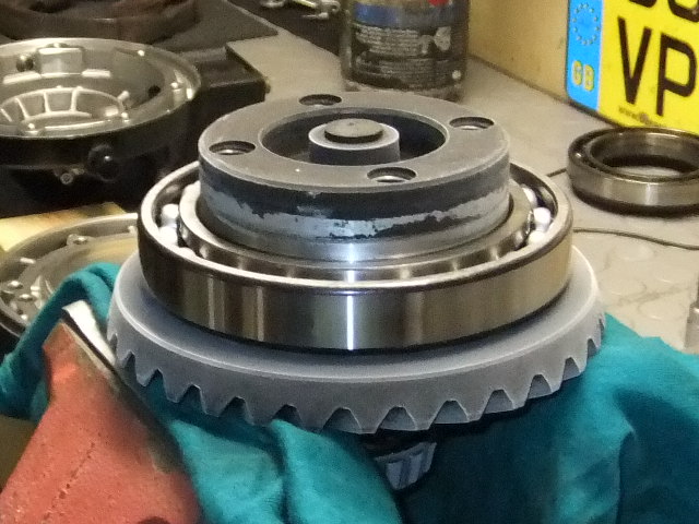

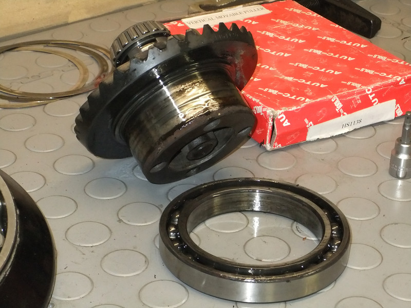

Now the only bit that can cause a bit of grunting and cussing, separating the bearing from the Crown Wheel. Tyre levers will do, or old screwdrivers if you have no pry-bars.
It's not that it's particularly difficult to separate the two, nor do you really need to be that careful as the bit that is most likely to be damaged is the bit that you will be replacing - the bearing.

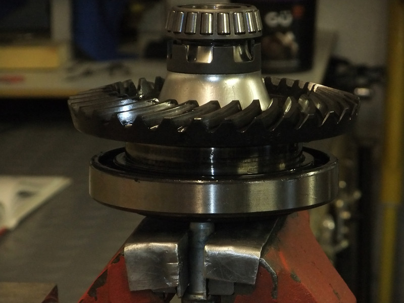

In my garage I use two old rear wheel bolts screwed into the Crown Wheel and clamp them in the vice. Then start to lever the bearing downwards. Once it begins to move, it becomes quite easy from there:
A bearing puller is nice but that presents the problem of how to hold things while the puller does its work. You do not want to clamp the the other end and damage the taper roller bearing (which very rarely needs replacing but is more involved to do so).

Push out the old seal. Lubricate the new one and fit it into the cover plate making sure that it sits flush (have a good look at the old one and how it seats level before you remove it).

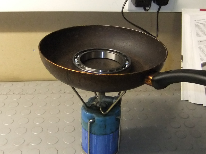

After the Crown Wheel has had half-an-hour or more in the freezer, take the new bearing and heat it up. Warm it is possibly a better description. It doesn't need to be very hot as the cold Crown Wheel will do more work for you. I use an old non-stick pan and a "bluey":
