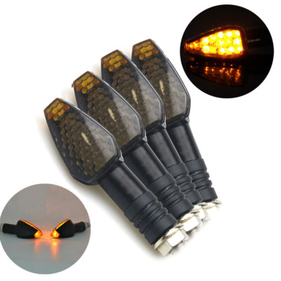

Both the front indicators on my bike are pretty beaten up and are held together with glue and tape. Is there an alternative to the horribly expensive and fragile o/e kit? Universal ones don't really fit as they tend to be 8mm thread, and the o/e ones are 10 or 12mm.

These aftermarket LED as linked above, what modifications are needed?
Because they are LED, from what i have read over the years, the will flash at 2X rate.
How does one prevent that with the original wiring system?
2 options
1/ Parallel resistor 25W rated
2/ Mod to the flasher unit (IIRC its in the font of all knowledge) by cutting a track
