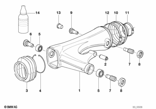

There is often a bit of adjustment in the bearing that can be nipped up. Slacken the locknut and give the item numbered 7 a nip up.
Just saw this thread. I have a small amount (1mm max) of play 6 to 12 on 1150 GSA rear wheel (2004 and only 30,000 miles). I think that means paralever bearings play or worn. Do you have a torque for that no. 7 bolt? Or just take up any play if the bearings aren't worn. Does no. 6 need a nip up too?
Local stealer said I needed a new RD.....but no movement 3 to 9 direction. Only 6 to 12.
