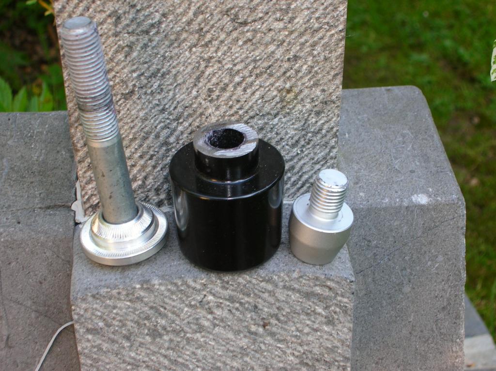

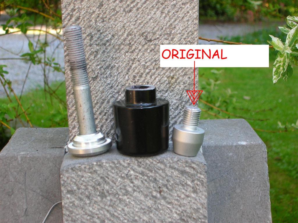

Can you fit 1200GS handgaurds and bar ends to the HP2? I find that without the balancer shaft there is a fair amount of vibration through the bars and i thought that this may help reduce it.

Lots of aftermarket bar end weights out there that I'm sure would fit, can't do any harm trying....:nenau
Richie
Yes
