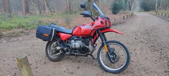

Hi all,
I'm looking for help with identifying and sourcing parts required to fit a PD fuel tank on a standard R100GS.
I have found a tank that I will need to paint.

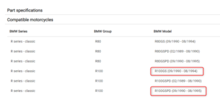

A browse of the Motorworks website and a call to their sales line, had me thinking that the standard vs PD panels were the same, that is despite visual references saying otherwise - because the panels on the classic certainly did not look like they were the same as on the PD in photos.
Today, I took off my standard tank and slid the PD tank into place and there is no way, the standard fairing is going to work!
I did look all over eBay, UK, France, Germany, USA and Italy sites and could not find a single example of a PD specific R100GS fairing/panel.

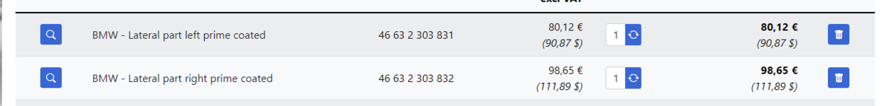

I have found a supply of a pair of new panels, using the part numbers from the Motorworks site, but again Motorworks shows those parts as compatible with both the classic and PD bikes and I am concerned that I will be ordering panels that are the same as on my classic bike, not for the PD.
I'd be grateful for any advice.

Try realoem.com , parts are listed as different nos. but indicating ended so you can only hope for some old new stock

I’ve seen your pm but I thought I’d answer here so everyone can chip in. Way back when I had the second generation R100GS as per your red picture. I bought it new but really wanted the GSPD. At that time it wasn’t available in the UK as the plastic tank wasn’t legal. Originally the GSPD was a kit from the factory. Later available fully made up as a separate model.I ordered the parts from a UK dealer and you surmise correctly the side panels to the fairing are indeed a different shape that butt up to the much larger GSPD tank rather than overlapping the smaller one. There are rubber gaskets needed too. As far as I recall everything else will fit your GS frame.

I placed an order yesterday for a supposedly available pair of primed fairing panels (NOS) and tank/fairing join rubbers - the order was cancelled this afternoon as they were not actually in stock.
So, I guess I'll be searching eBay until I find a pair of these fairings, until such time the tank is going to be in storage!

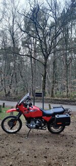

I don't think the standard panels are shapable to fit the new PD tank and I don't want to be wrecking the current bodywork of the bike as I might well put it back to standard, should I ever sell it.
So, I will probably keep the standard tank with that in mind.
I've already fitted a third-party high mudguard which I rattle-can painted red - it doesn't look half bad IMO.
