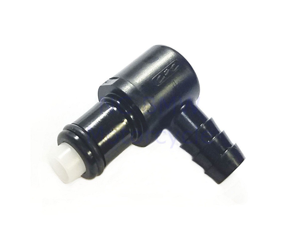

2004 1200GS Fuel leak at pump QR

Looks the recall has been done as you can see the metal collar round the base of the spigot.
Small o ring need looking at ? Keep the release tab pressed in when putting them back together, stops the o ring being damaged as it passes through the locking tab.

Cheers!
I hope that's all it is.
I have a selection of O-rings somewhere safe.....
:blast
When was the recall done? Do you have a case to take it back and have it done properly?
In the meantime, grease the O-rings and see if that helps them to seal better. Petrol isn't gentle stuff so ordinary grease should be OK, but if bothered use red rubber grease.
