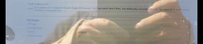

Had my temp warning light come on in traffic last weekend. 2012 650GS SE - 37k miles
Luckily I have GS911 ( see piccy number 3)
I tried to cycle the fan to come on via the GS911, but no joy.
Rang my local BMW dealer = £176 for a new fan motor, I don't fink so.
Found a 2017 fan from a F800GS Rallye on eBay, that had done 3k miles b4 front end smash.
£60 or offers, got it 4 £50 posted.
Arrived in 3 days.
Checked the date on it when it arrived & definitely a 2017 fan.
The seller is selling loads of other parts all imaculate.
Plus 100% feedback on over 4k items..
Fitted it this afternoon, now working great..
Only tools needed - 2 X torx bits, 2 cable ties & pliers to open the hose clamps.
Majority of time consumed was removing / refitting all the plastics.
:thumb

Luckily for me it was just the fan...
My old one was very notchy & not easy to turn by hand.
So I think it was triping out & hence the fault on puter readout.
