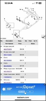

In my swap GS to GSA I’m changing to the metal panniers, I’ve got the frame and majority of parts with the exception on the fitting items circled below. I’m sure I can use just normal nuts and bolts but like to use the proper fittings.
So before going to BMW and me calling out a wrong number wanted to ask if anyone’s got fittings kicking around?
Also anyone know if I can order by part number online as opposed to phoning and reading it all out?
Part number: 46547699778
M5x30mm filleter head screw x 6
Part number: 46547699810
M8x50mm filleter head screw need x 4
Part number: 63127699141
M6X40-A2-70 Fillister head screw x 2
Part number: 46547698986
Bush need x 2
Part number: 46547698985
Bush need x 2
Anyone got anything kicking about, I’m in no panic.

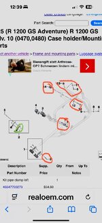

Last request, items in image 1&2 I have these clamps but they are not captive, it doesn’t list a nut for them (highlighted in green) below what are they is it simply an M5 nut and washer or they something else??
Ta
Ref 1&2 On all the ones that I have seen the nuts have been captive.
It’s odd, the ones I got with the frame don’t look captive
From what i can see there are like clip in captive nuts that mine are missing and they don’t show as individual to the full clamp. Oh well adapt some nuts it will have to be..
Your are correct on missing parts, please check this drawing, which shows the captive nuts, screws for your pipe clamps.
Items 10# Pannier Pipe Clamp Cage Nut + 5# Fillister Head Screw M5 x 30MM
Look under 71# equipment parts and scroll down to:- 77_0142 - CASE HOLDER/MOUNTING PARTS
